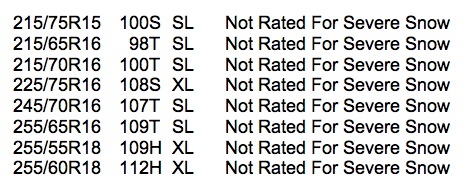

J'ai trouvé un exemple, le BF Goodrich All Terrain T/A KO :
While most BFGoodrich All-Terrain T/A KO tires meet the industry's severe snow service requirements (and are branded with the mountain/snowflake symbol), selected tires do not.
Specific tires/sizes not meeting the industry's severe snow service requirements are identified with a "Not Rated For Severe Snow" notation on the Sizes & Pricing, as well as on Specs.
Voici les dimensions qui n'ont pas le symbole flocon :

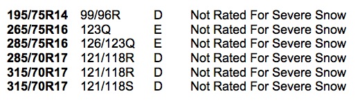

Voyons maintenant pour le Grabber AT2, les dimensions qui n'ont pas le flocon :
