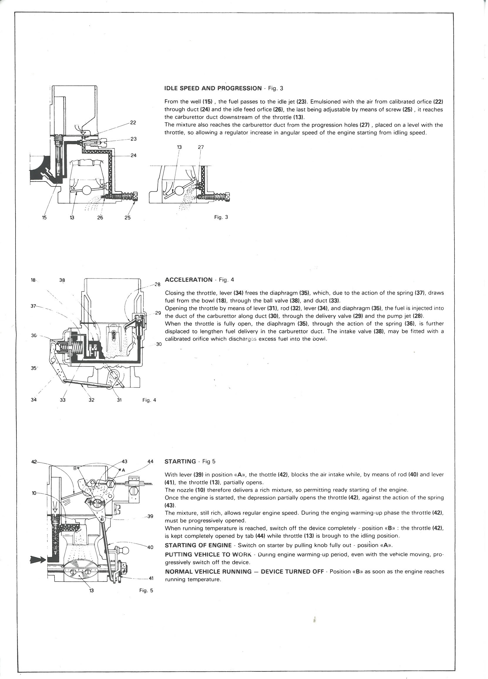

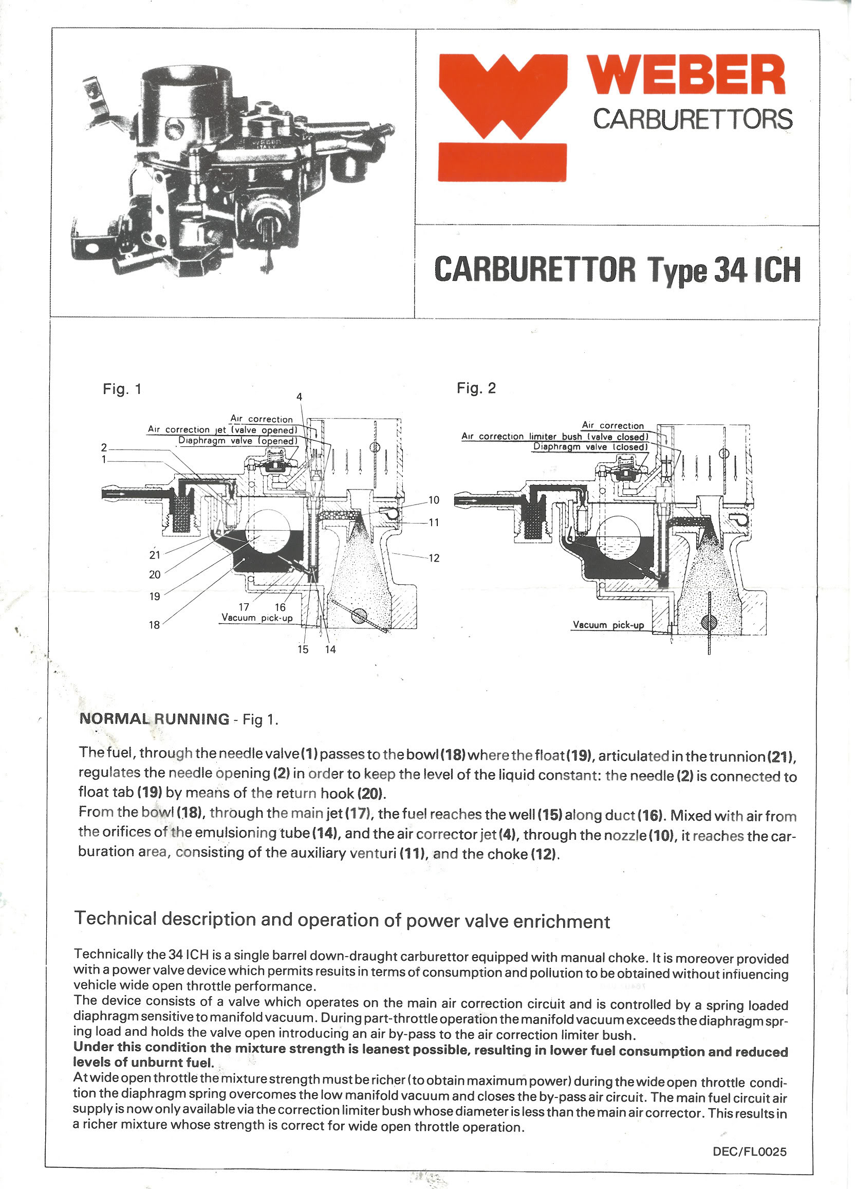

Un peu de documentation Weber sur le 34 ICH (générale, car c'est un carburateur de remplacement aftermarket qui s'adaptait sur de nombreux moteurs, dont chacun suppose son réglage propre) :

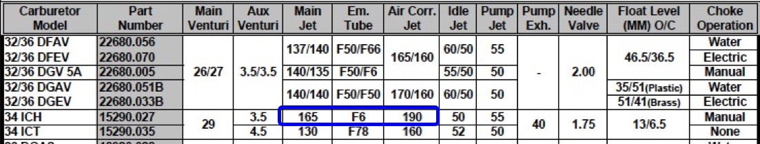

Il y aussi quelques indications sur les réglages de base (source: Carolina Rovers), voici ce qui est dit :
"The Weber 34ICH is a generic carburetor designed to be closely adaptable to individual engines. This means that the jetting is complicated enough to require an expert to get it tuned as close as possible to your engine’s needs.
However a 165 Main Jet , 190 Air Correction Jet and F6 Emulsion Tube will normally get a stock 2-1/4L engine running acceptably well at or near sea level.
At around 7000 feet try a 155 main jet. Webers tend to be sensitive to altitude changes and need to be leaned out at around 5000 feet for proper running.
While the 34ICH has more top end power than the Zenith it is the most susceptible to dirt and water in the fuel and can frequently cause problems if the fuel is not clean and well filtered. The Weber’s main jet is located at the bottom of the float bowl, where it can be clogged with gunk. The Zenith and Rochester have their main jets supported from above, and are less susceptible to clogging and moisture."
