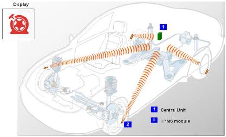

Int. Tire Syst.: The non-battery-operated tire modules communicate directly with the vehicle electronics (trigger optional). The temperature and inflation pressure of the tires is shown on a display.
TPMS: Tire Pressure Monitoring System
TPMS (Tire Pressure Monitoring System) measures inflation pressure directly. It consists of a central receiver (e.g. remote keyless entry) and four rim modules. The modules measure the current tire pressure, taking into account the temperature of the tire. The tire position is determined automatically with the help of the electronic brake system (EBS). An instrument panel display alerts the driver to an excessive drop in tire inflation pressure.
Integration in EBS also makes possible other useful functions – without requiring any extra sensors. These functions include load-dependent alert thresholds and a supplementary DDS backup option.
TPMS: The signals from the rim modules are picked up by an electronic control unit (ECU). A signal lamp on the instrument panel alerts the driver to an excessive drop in tire inflation pressure.

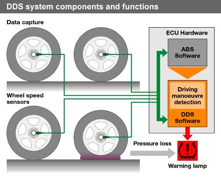

DDS: Deflation Detection System
The Deflation Detection System measures tire inflation pressure indirectly and alerts the driver immediately in the event that inflation pressure drops below a defined threshold. The Continental Deflation Detection System is a 100% software solution that evaluates the data from the ABS wheel speed sensor. It gets by without any sensor system of its own. Any loss of pressure changes the radius of the tire and results in a specific electronically detectable alteration in the speed signal. The system alerts the driver in the event that tire inflation pressure drops below a specified limit value. Many vehicles with Continental runflat tires are already equipped with DDS.

Re: on voit que sur le TMPS (qui semblerait être celui qui équipe le RRS), la position de chaque capteur est connue par sa position géographique et non un codage du signal. Le propriétaire peut donc permuter les pneus.
Reste à voir ce qui se passe si on roule trop près d'un autre RRS :lol: :lol: :lol:

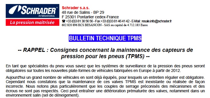

Salut Kebir, je retiens l'insistance de VDO sur la nécessaire formation technique de toute la chaîne d'intervenants. Aux US, étant donné que le Tread Act est entré en vigueur en 2007 ils ont pris de l'avance.
Mais chez le Speedas ou le Midy du coin, je ne suis pas bien sûr qu'ils aient encore tout intégré :roll:
Sinon, prix public HT du capteur Range Rover dans le catalogue VDO = 35€, et pochette de pièces de rechange (valve, joints, bouchon) idem.
NB : prix du capteur pour une Citröen C4 = 75€ et pour un break Volvo = 90€ ! il y a quoi comme électronique dans ces capteurs pour atteindre des prix pareils ?
Rien qu'avec les pochettes de pièces de rechange, j'ai idée que l'on va voir notoirement grimper le tarif de la prestation démontage-montage de pneu dans les centres de pneumatiques. D'autant qu'ils vont devoir amortir l'investissement en matériels de diagnostic et re-paramétrage. Il y aura cette ligne en plus sur la facture, pour le recalibrage des capteurs.

kebir31 a écrit : on voit que sur le TMPS (qui semblerait être celui qui équipe le RRS), la position de chaque capteur est connue par sa position géographique et non un codage du signal. Le propriétaire peut donc permuter les pneus.
Pas sûr pour l'auto-localisation. Les capteurs TPMS ont deux systèmes de fonctionnement, et je ne sais pas lequel équipe les RRS, sans compter que cela a pu changer entre 2006 et 2012 :
1/Système avec ré-initialisation : si un capteur est changé et remplacé par un neuf, un apprentissage avec outil de reprogrammation est indisensable.
2/Système sans ré-initialisation, par auto-rotation (WAL : Wireless Auto Location Technology) : la technologie d’auto-rotation permet d’identifier la position de chaque roue. Une reprogrammation n’est pas nécessaire en cas de changement de la position des roues ou montage d’un nouveau capteur.
Je chercherai dans une doc RR...

Salut, dans le principe tu as raison. Mais si tu demandes aujourd'hui à tel propriétaire, au hasard d'une Audi, combien lui a coûté une deuxième monte de roues, mettons en pneus hiver...
- avec l'équipement en capteurs TPMS, (sinon le conducteur passe l'hiver avec l'alerte pression allumée en permanence)
- plus le passage quasi-obligé chez le concessionnaire, parce que Speedas ou Midy n'avaient pas l'outil avec les bons protocoles, pour l'activation-programmation des capteurs en liaison / fréquence radio avec le récepteur embarqué
- plus retour en concession suite à un dysfonctionnement avec un signal-code erreur de l'un des capteurs
- plus refus de prise sous garantie au prétexte que la tige de valve a été cassée (le monsieur ayant voulu vérifier manuellement la pression du pneu défaillant, forcément c'est lui qui a fait une erreur de manipulation et qui a cassé sa valve...)
Bref, en exagérant à peine :sm11: , cela aussi est une perte de temps et d'argent, non ?
jean-yves 26 a écrit : c'est une mesure qui est faite pour les négligents, les sans soucis, les inconscients...malheureusement de plus en plus nombreux.. donc pour moi ça ne me choque pas d'imposer ce type de mesure bien au contraire
A condition que ne soient pas non plus négligents les techniciens du pneumatique, voire l'apprenti à l'atelier, qui vont s'occuper de la chose. Or, une note d'information de chez Schrader peut laisser craindre un léger manque de rigueur :
Note technique dans son intégralité, ici :
http://www.schraderinternational.com/Do ... 2206008aaa

Très intéressante la note de montage des Snap-in Schrader. :mrgreen:
Espérons qu'il aura véhicules de courtoisie :sm11: . J'ai comme l'impression qu'il va y avoir quelques naufragés du capteur cassé/pas dispo. :mrgreen:
Sans compter que ça fera l'objet d'une ligne de plus au CT ... avec les roros qui vont avec. :sm11:

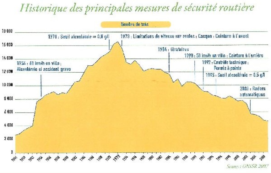

et globalement, l'année ou j'ai passé mon permis, c'est l'année de tous les records de morts sur la route soit 16500 morts pour 8 ou 10 fois moins de voitures en circulation. (ok les routes étaient merdiques aussi) m'enfin...

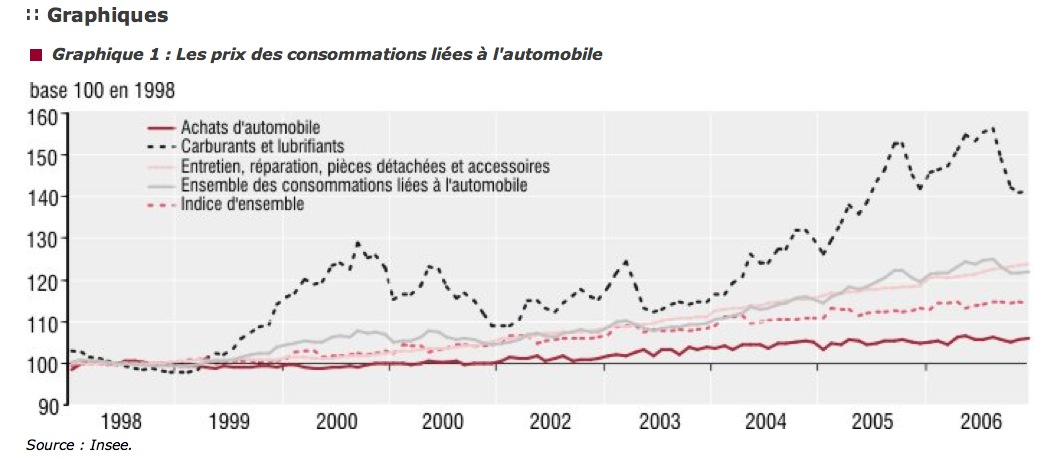

quant aux dépenses liées à l'automobile, mon père avait mis dans les années 50, plus de 9 mois de salaire intégral pour rouler en 2 CV !!! alors les dépenses pour la bagnole ne sont pas plus importante maintenant qu'hier, ne confondons pas avec les besoins de consommation sans cesse grandissant qui grève toujours plus le budget des ménages 8)
Messages : 2319
Re: usure et déchirage flanc de pneu Range Rover sport
jean-yves 26 a écrit :l'année ou j'ai passé mon permis, c'est l'année de tous les records de morts sur la route

jean-yves 26 a écrit : les dépenses pour la bagnole ne sont pas plus importante maintenant qu'hier, ne confondons pas avec les besoins de consommation sans cesse grandissant qui grève toujours plus le budget des ménages 8)
